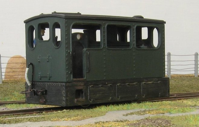

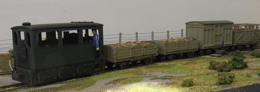

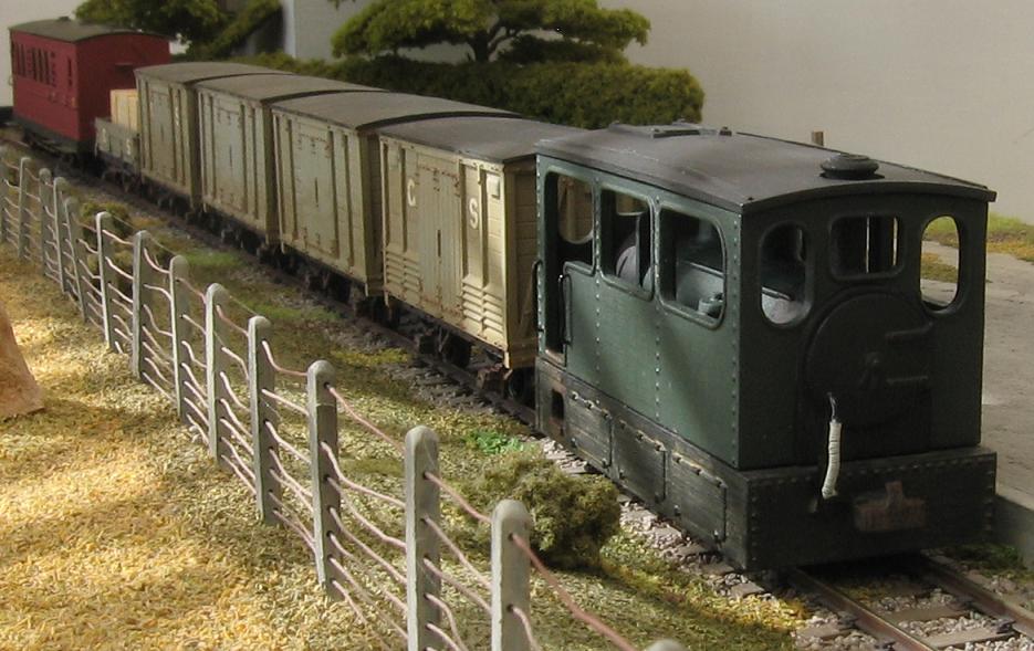

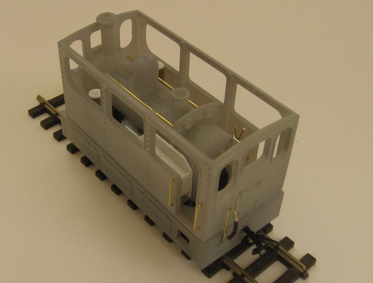

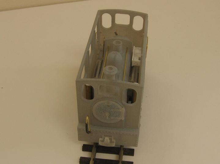

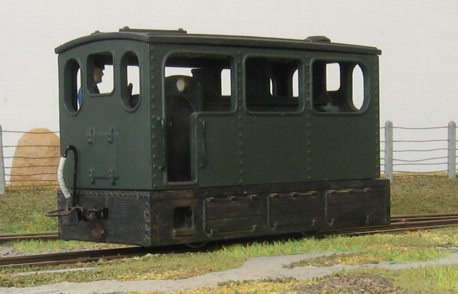

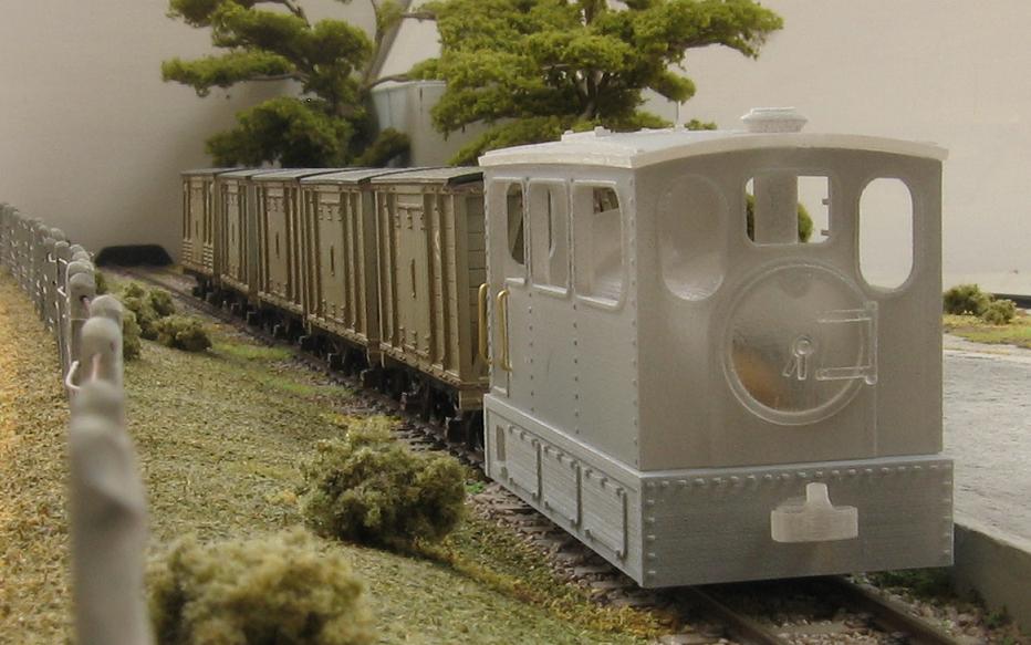

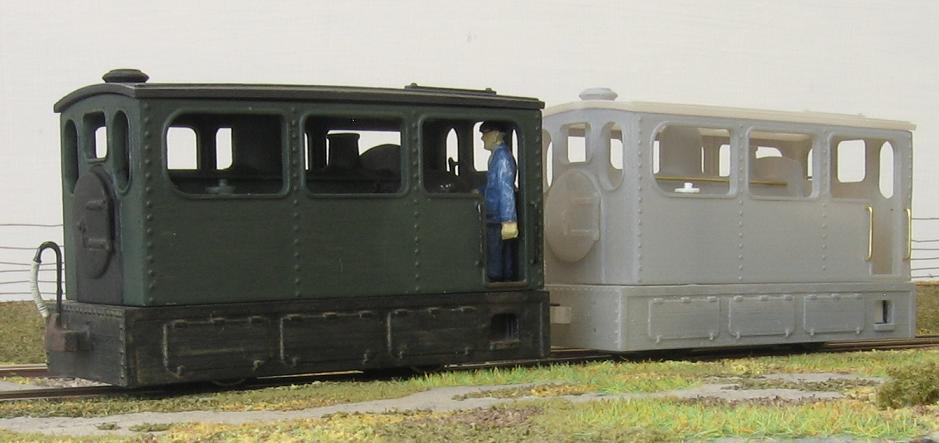

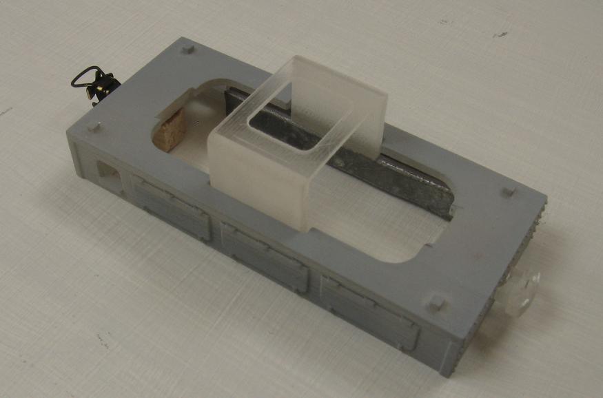

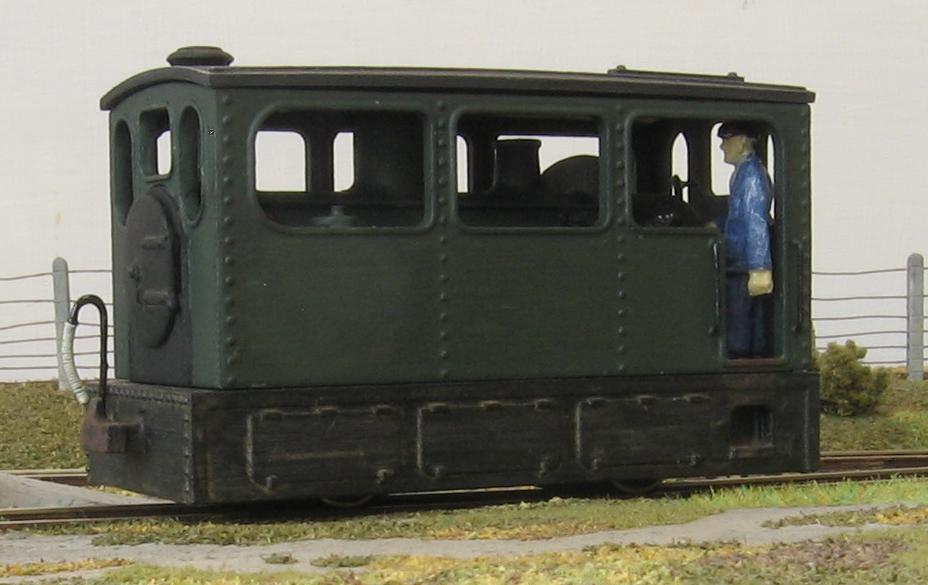

Dear all,

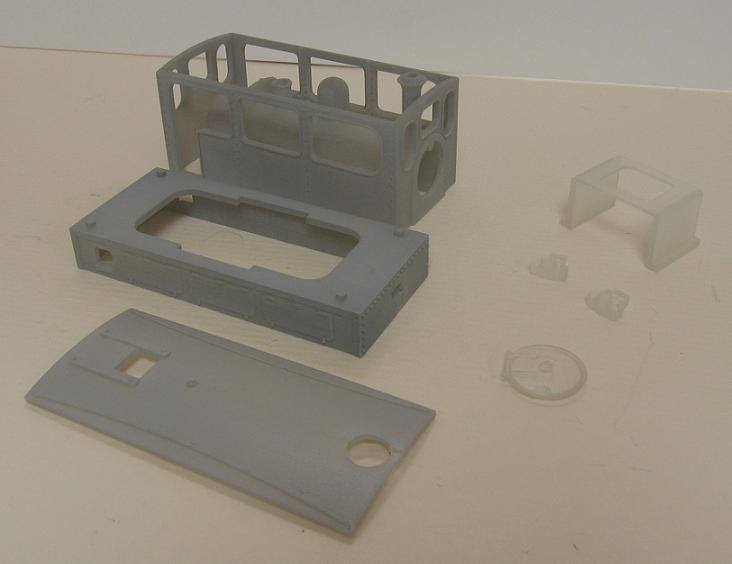

Chris Ward (cwrailways.com) has produced a 3D printed tram loco to help modellers of 00n3 (1:76 or 4mm/foot or 13mm/metre) get started without the need for a soldering iron. It runs on a Halling motor bogie, a good mechanism in my experience.
It stands 40mm from track height (42 mm with chimney), is 28mm wide and 64mm long (excluding buffers). It has been designed to be used with the Parkside Dundas T & DLR vans which some people on the group use on their layouts.
There are 7 parts - footplate, motor saddle, body with boiler, smoke box door. roof and two buffers.
It is a entry level kit. It is down to the modeller how much/what detail to add. Once the motor saddle is glued in place the loco is ready to use. 5 minutes of careful work maximum.
I have included photos. Some have the T & DLR stock, an other has the Isle of Man Railway stock (Branchlines - no website).
Chris is prepared to sell the footplate & saddle separately.
I need to add works plates, number plates, a whistle (or bell) and another crew member to finish off.
It may be of interest for modellers of 1:87 scale.

Jolie loco. Un style un peu vicinal hollandais.
Re: Steam tram loco in 1:76 scale
Messagepar Paul T » 14 04 2015 à 21:41
Yves, un commentaire intéressant. Maintenant, je pensais que ce était un type belge / française de loco. Cependant, vivre sur une île, je ne suis pas expert de sorte qu'il a changé à un style vapeur tram locomotive belge / hollandaise dans mon stock livre!
Je pourrais obtenir quelques Blanc Misseron fonctionne plaques pour cela, je espère que cela ne déranger personne.

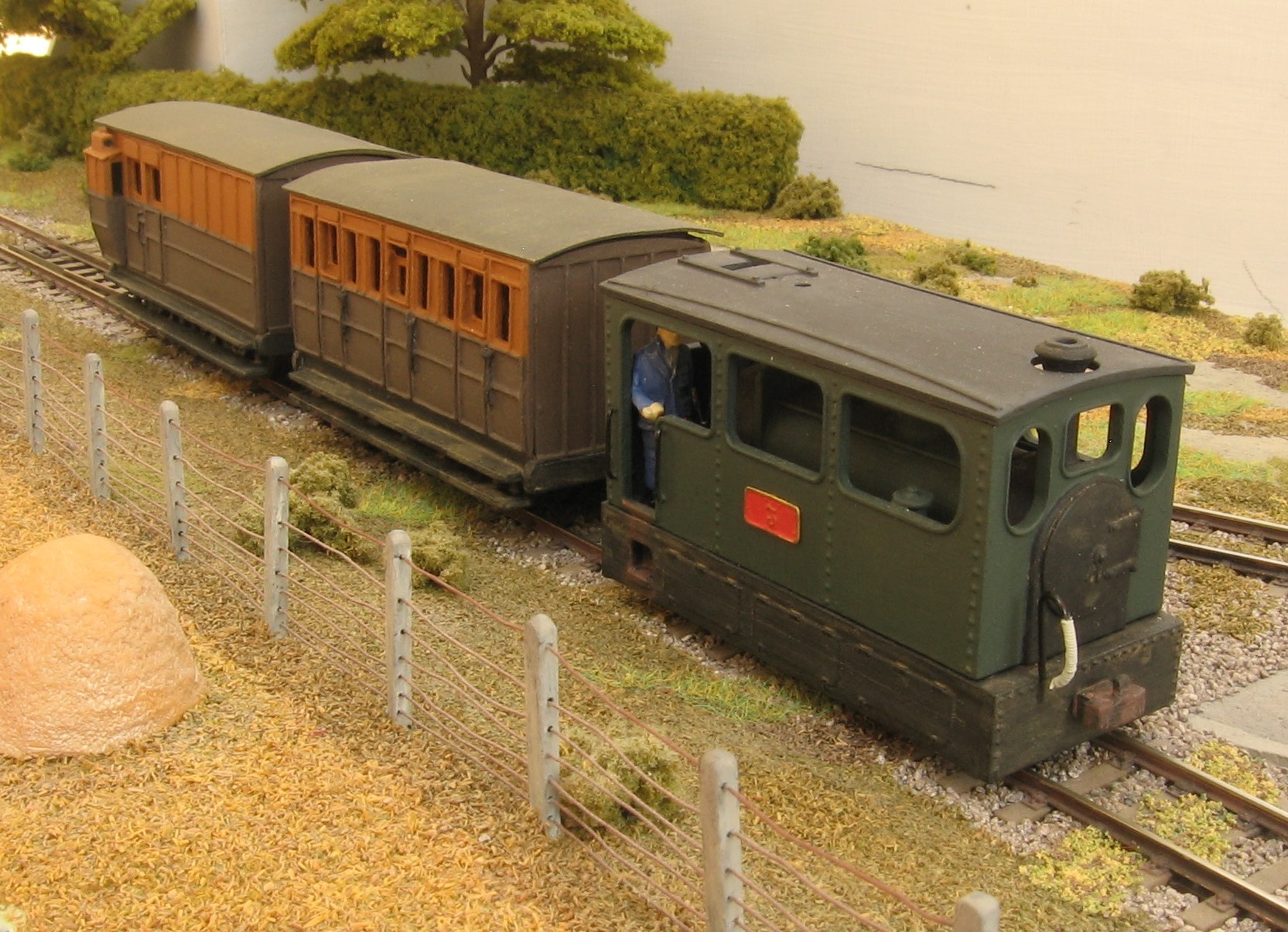

Hi.
The tram trundles through Lispole with some ancient white metal kits - an Isle of Man 4 wheeled coach and brake van. These kits were probably cast in the late 1960's, now nearly 50 years ago. State of the art at the time - state of the ark today. Technology progresses ...
Best wishes,
Paul

Mariage sympathique, les deux styles vont bien ensemble.

Thank you Yves. I thought they went together well - something of a pleasant surprise. A marriage of the old (white metal) with the new (3D plastic print.) :^)
It may spur me on to put together the artwork for one of the '3 foot' Ravenglass & Eskdale coaches (railway closed 1913). I have some diagrams to help (from Peter Kazer, a respected modeller). Just need to finish the Billard remorque first ... I hope that Allen Doherty will be make an etch brass kit for the coach.
I hope the photo is acceptable on Passion Metrique.

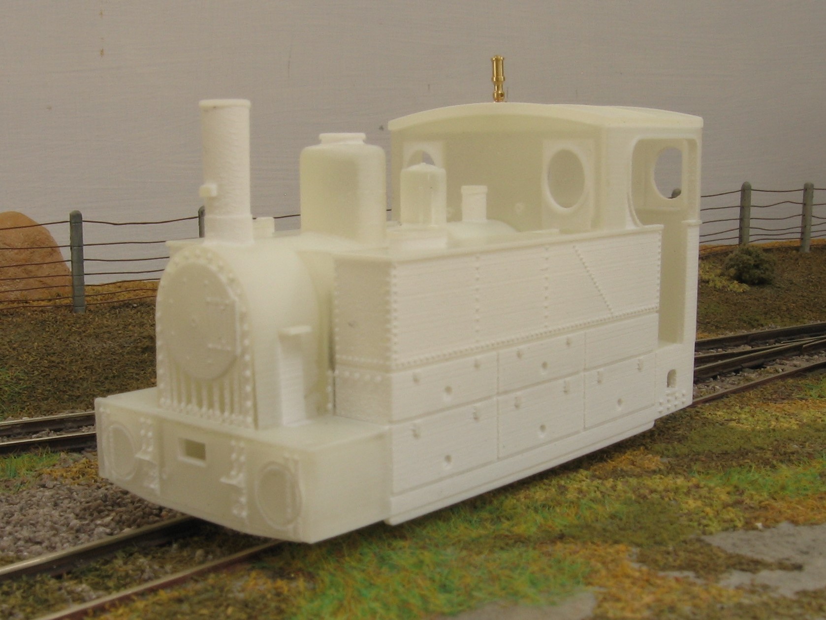

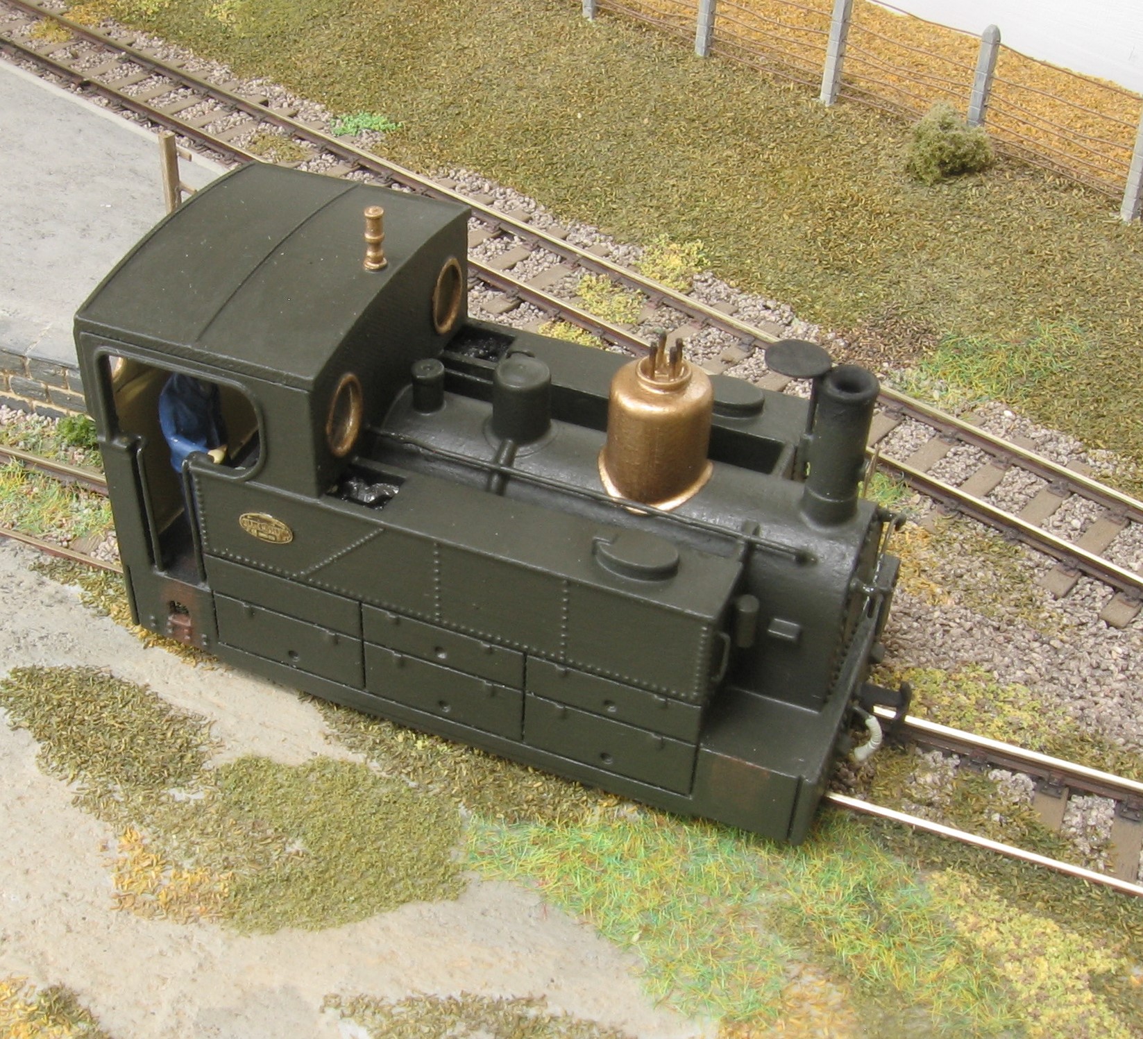

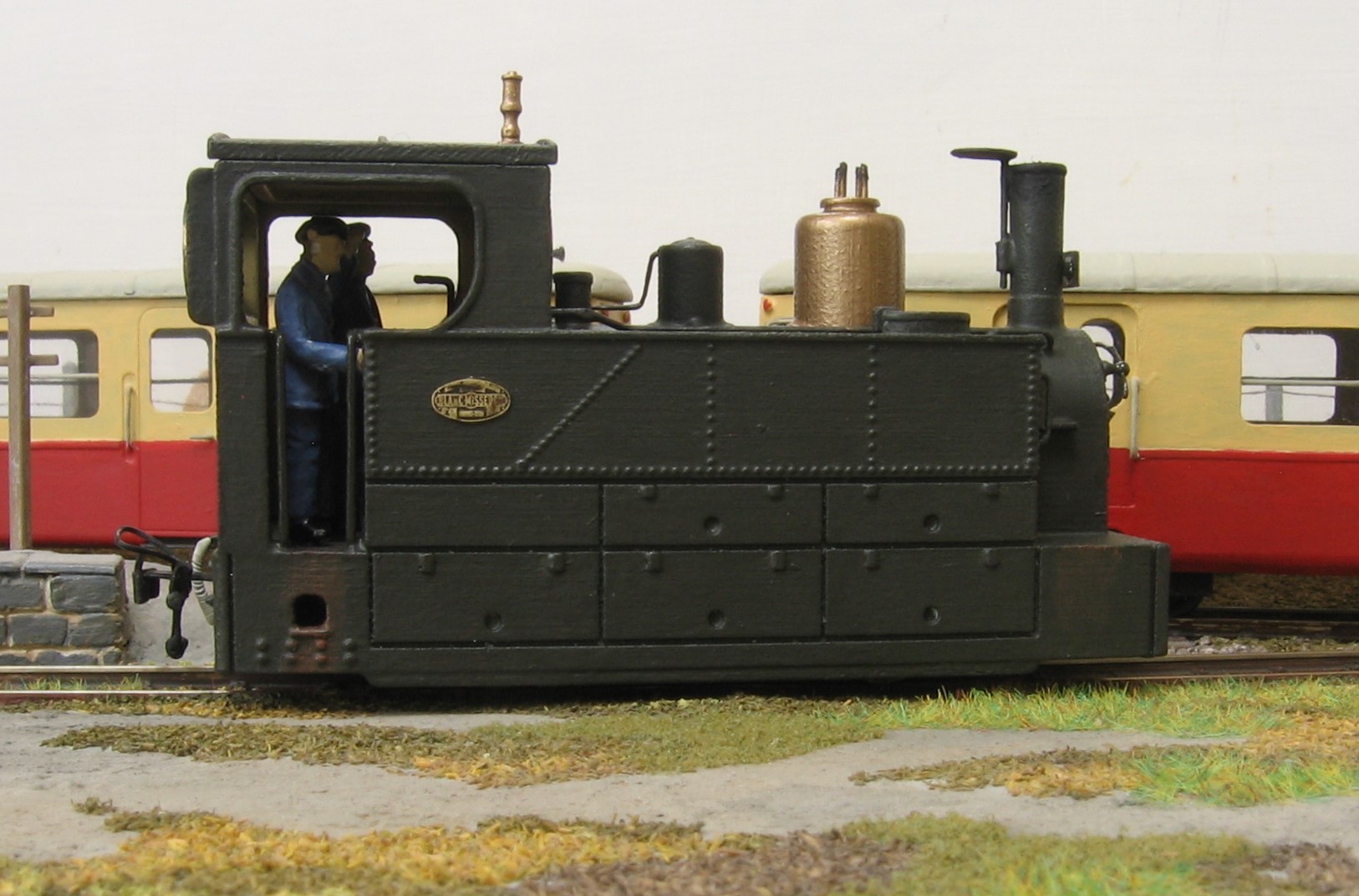

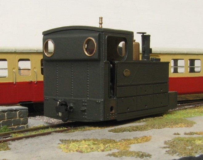

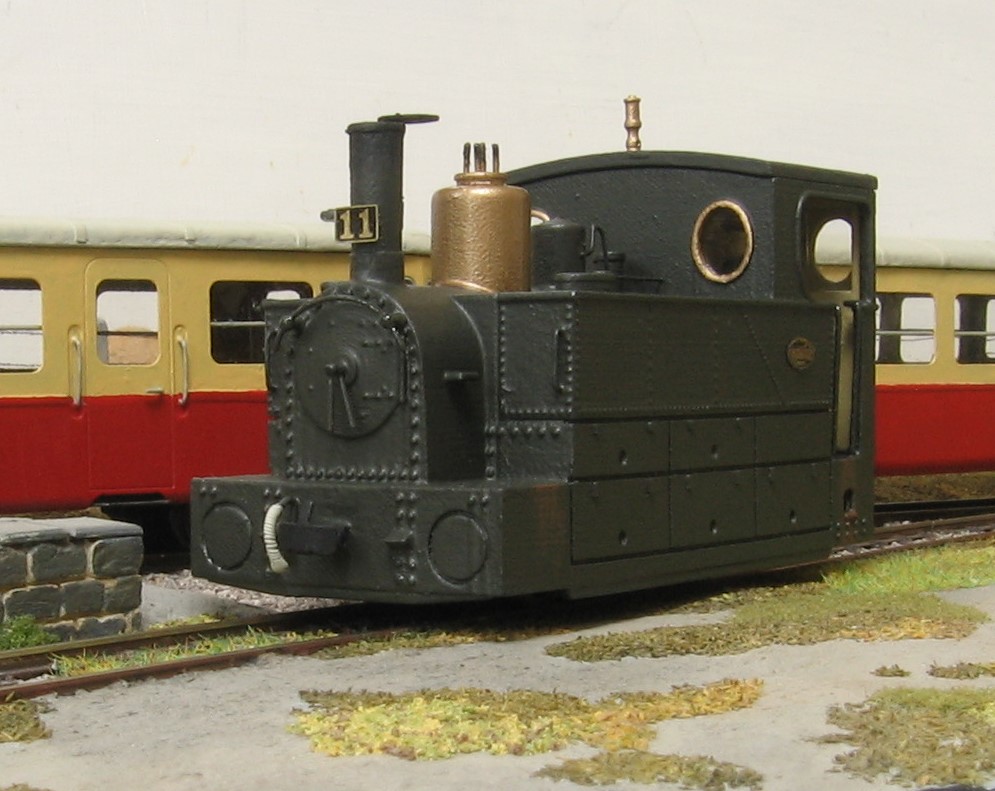

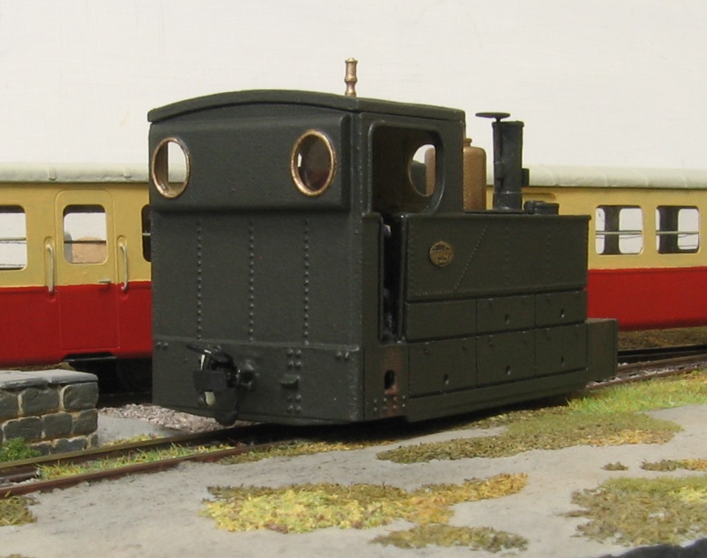

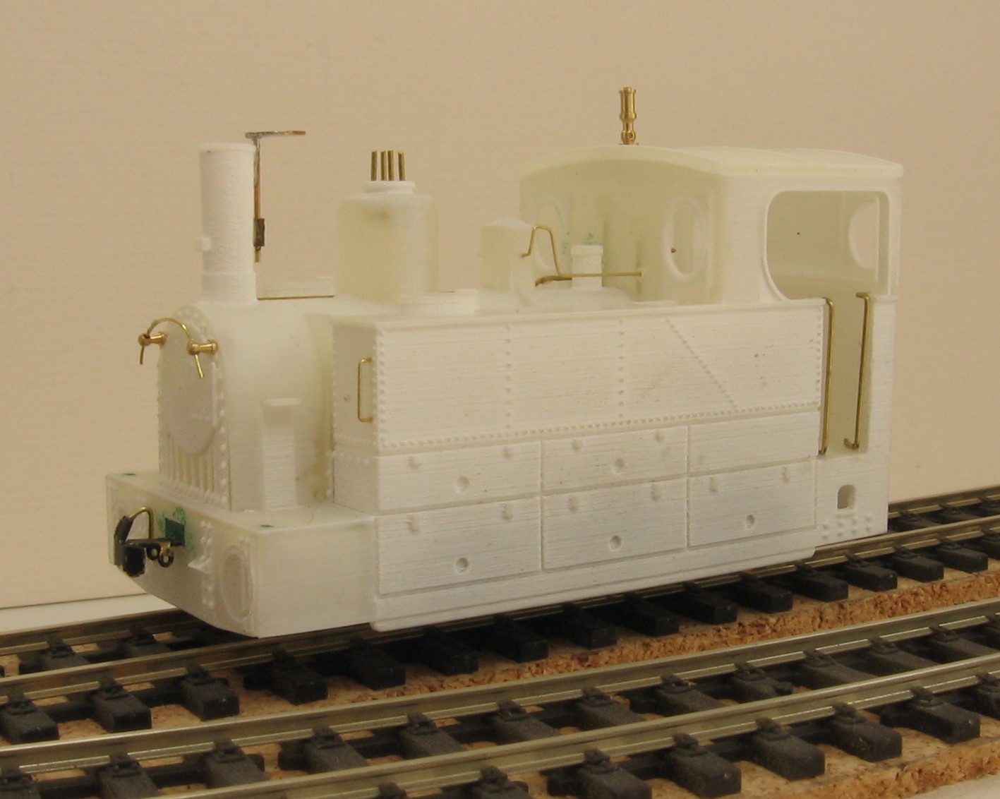

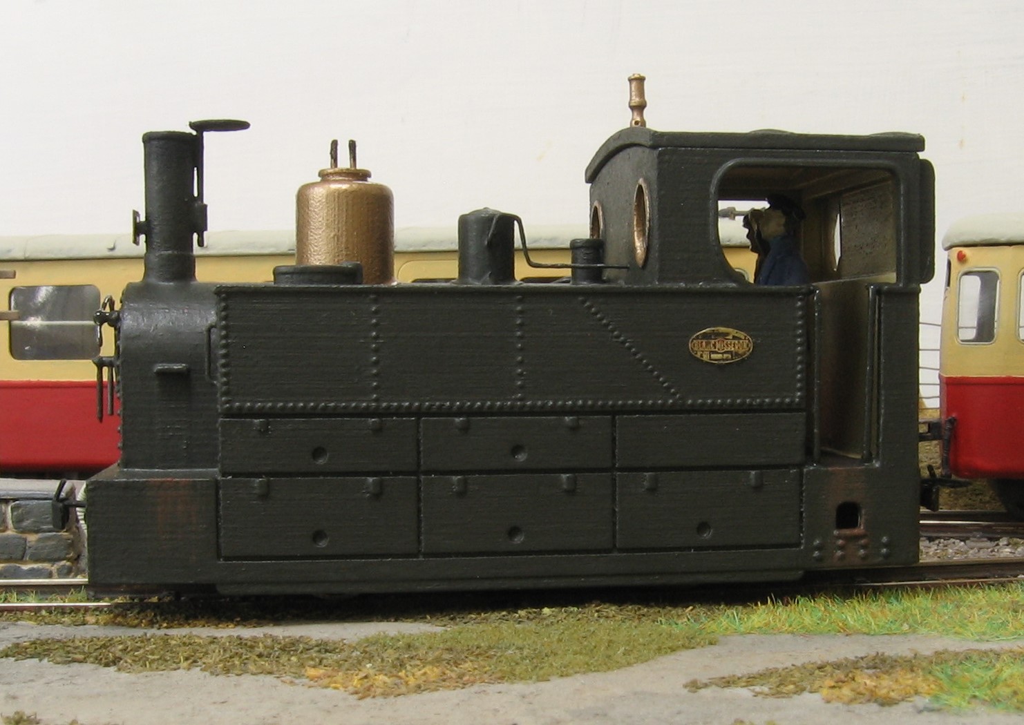

Dear all,
Another tram loco for 1:76/00n3. This may be a 'Marmite' locomotive! Mostly CdN 030-T Blanc-Misseron but with some features - especially cab sides, boiler and smoke box inspired by loco 108 on the Sarthe Tramway. IT IS NOT A SCALE MODEL OF THE SARTHE TRAMWAY LOCOMOTIVES. It runs on the Halling motor bogie. I expect it to be reduced to 1:87 for HOm and HOe at some point soon - for those who may be interested. The photos show it as received, improved, painted and completed. It was printed in FUD by Shapeways for Ivan Industries.
That's all!
Best wishes,
Paul

Vue arrière/Rear view - J'ai eu un gâchis en publiant les photos/I got in a mess posting the photos.

Trés joli !
La locomotive sera-t'elle disponible au 1/87ème ?
