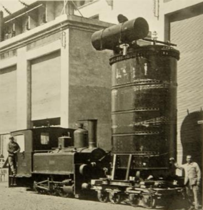

- Corpet N°1023, CA n°51 La Seine. On dispose d'une photo, où l'on voit cette machine dans les rues de Saïgon, où elle porte toujours sur la traverse avant le n°51, comme sur les CA, dont peu de temps après son arrivée.

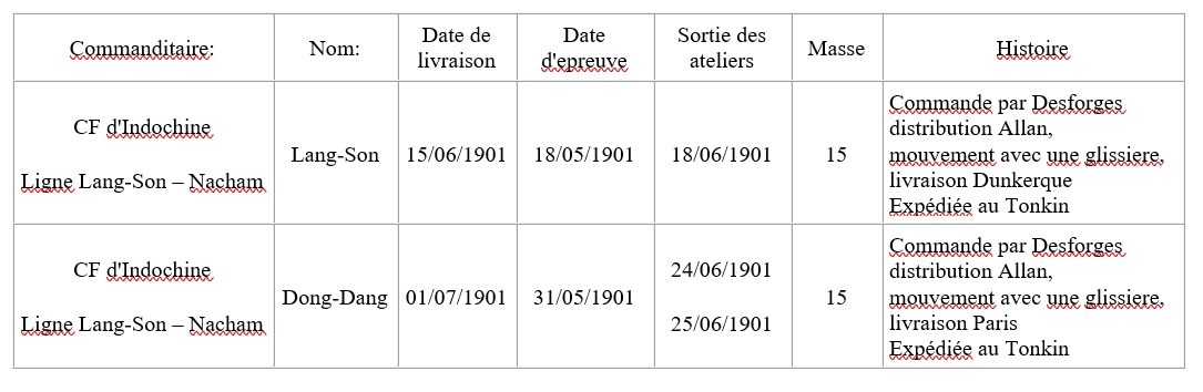

Further re. the mystery of D 842 Cn2t "Lang-Son" & D 843 Cn2t "Dong-Dang"
With the kind help of the author of the last C&L book I have received another delivery list with the details for these two locomotives stating that they were actually exported immediately after the delivery (and have so never been used in France).
The delivery list also states their weight at 15 tons.
Quite weak for a railway company that already had much stronger locomotives on their roster.
Interestingly these two locomotives never got their road numbers, just the names of the last two stations on the then recently regauged Decauville line to the Chinese border.
The train on the photo could be the farmers market train along the Red river villages described in the “Le chemin de fer du Fleuve Rouge et la pénétration française au Yunnam / capitaine Ibos” @ https://gallica.bnf.fr/ark:/12148/bpt6k ... 6/f20.item
Isn’t it a bit strange for an established railway company to buy locomotives through a stone quarrying company?
Maybe Desforges realized after ordering that the locomotives were not needed any more for their stone quarrying business?
It is probably not too wild of a speculation that they might have ended in the coal mines of Tonkin where No.708 was sent earlier.

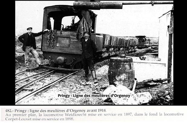

The only photograph of the C&L on the stone quarry railway is most likely the C&L locomotive that Desforges have acquired earlier and was there until the Decauvillisation of the track in 1924
https://www.asso-mpv.com/photos-ancienn ... -essonnes/
D 723 , Cn2t , 1000 , 03.09.1898 - Desforges, Orgenoy-Ponthierry / 1926 Carrières de Bretagne et de Normandie, carrières d'Etavaux, St André-sur-Orne (Calvados)

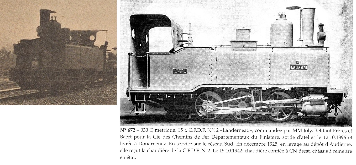

I still believe that the closest relative to this couple would be No. 672 Landerneau.
From the times when the weight of the loco was important I can see the only difference being the shape of the sand dome (and the counter arguments are more than welcome).

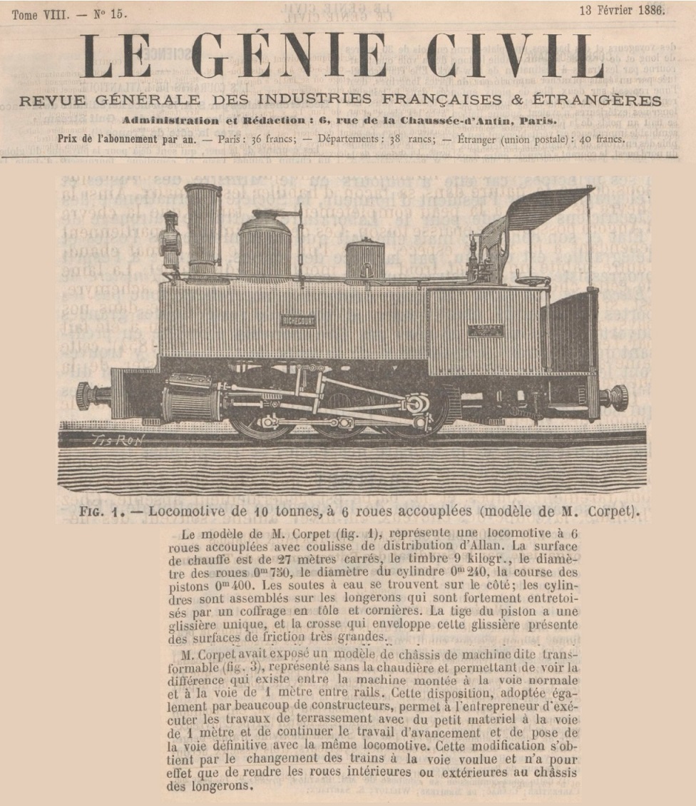

Re. D 433 Cn2t 1000 08.04.1885 Marlaud Père & Fils "Richecourt"
Le Génie civil : revue générale des industries françaises et étrangères. 1886-02-13.
https://gallica.bnf.fr/ark:/12148/bpt6k ... w/f11.item
https://www.flickr.com/photos/189316830 ... 125240102/
